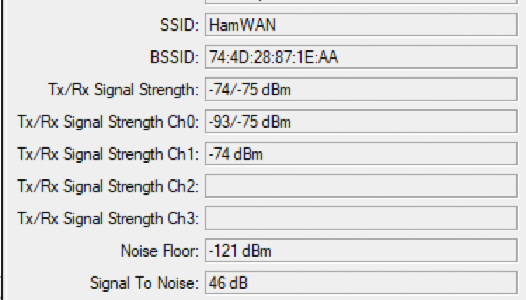

John, They are both running. I did not do anything special other than the client-configuration and manually setting the country to no country via the Wireless tab when the script failed during the item 21 configuration. ================ Bob Sampson k6mby@olypen.com 360-477-0776 (cell) Sequim, WA

Bob,
One out-of-the-blue question: Do you have both chains enabled on the radio? The factory default setting (for the RB912UAG-5HPnD at least) is to just enable chain 0. Last time I checked, the configuration instructions on the HamWAN web site don't enable the second chain (chain 1). Enabling the second chain can make a pretty substantial difference in net signal margin and stability.
Assuming that you are using a MIMO radio, to check this run:
/interface wireless monitor 0 once
You should have these lines in the display:
signal-strength:
signal-strength-ch0:
signal-strength-ch1:
tx-signal-strength:
tx-signal-strength-ch0:
tx-signal-strength-ch1:
If you only have the following, then you are running in single-chain mode:
signal-strength:
tx-signal-strength:
To enable both chains:
/interface wireless set 0 rx-chains=0,1 tx-chains=0,1
John KX7JM

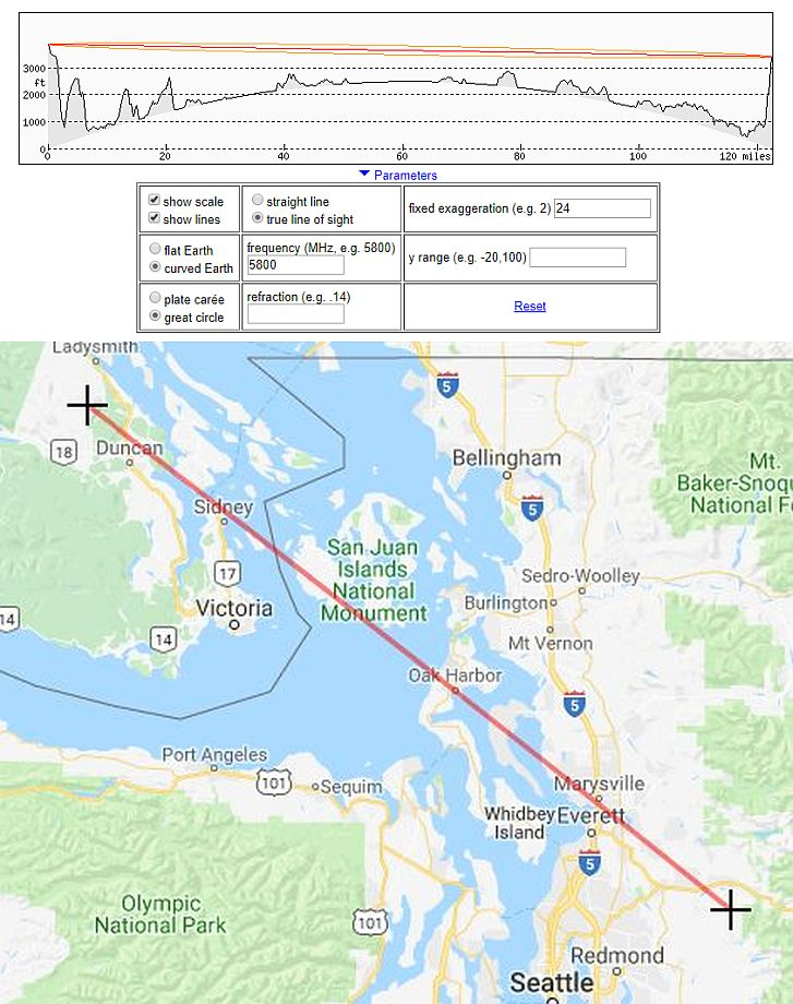

Bob, That's great! Looks like you have a respectable link--and maybe coverage from both Lookout and Triangle. It's nice to have confirmation of coverage moving toward the West in Jefferson County. John KX7JM ---- On Thu, 05 Mar 2020 13:15:07 -0800 Bob Sampson <k6mby@olypen.com> wrote ---- John, They are both running. I did not do anything special other than the client-configuration and manually setting the country to no country via the Wireless tab when the script failed during the item 21 configuration. ================ Bob Sampson mailto:k6mby@olypen.com 360-477-0776 (cell) Sequim, WA Message: 1 Date: Wed, 04 Mar 2020 18:05:20 -0800 From: John Miller <mailto:john@jmit.com> To: "Puget Sound Data Ring" <mailto:psdr@hamwan.org> Cc: "psdr" <mailto:psdr@hamwan.org> Subject: Re: [HamWAN PSDR] Configuration failure Message-ID: <mailto:170a870a733.efd11161166045.5362718638499091690@jmit.com> Content-Type: text/plain; charset="utf-8" Bob, One out-of-the-blue question: Do you have both chains enabled on the radio? The factory default setting (for the RB912UAG-5HPnD at least) is to just enable chain 0. Last time I checked, the configuration instructions on the HamWAN web site don't enable the second chain (chain 1). Enabling the second chain can make a pretty substantial difference in net signal margin and stability. Assuming that you are using a MIMO radio, to check this run: /interface wireless monitor 0 once You should have these lines in the display: signal-strength: signal-strength-ch0: signal-strength-ch1: tx-signal-strength: tx-signal-strength-ch0: tx-signal-strength-ch1: If you only have the following, then you are running in single-chain mode: signal-strength: signal-strength-ch0: tx-signal-strength: tx-signal-strength-ch0: To enable both chains: /interface wireless set 0 rx-chains=0,1 tx-chains=0,1 John KX7JM John C. Miller mailto:john@jmit.com (530)873-9005 ---- On Sat, 29 Feb 2020 05:51:14 -0800 Bob.k6mby <mailto:k6mby@olypen.com> wrote ---- Thanks Carl. Went in the wireless tab and set country and frequency mode then ran the regular item 21 config line and it went without error. Bob K6MBY Sequim, WA _______________________________________________ PSDR mailing list mailto:mailto:PSDR@hamwan.org http://mail.hamwan.net/mailman/listinfo/psdr
