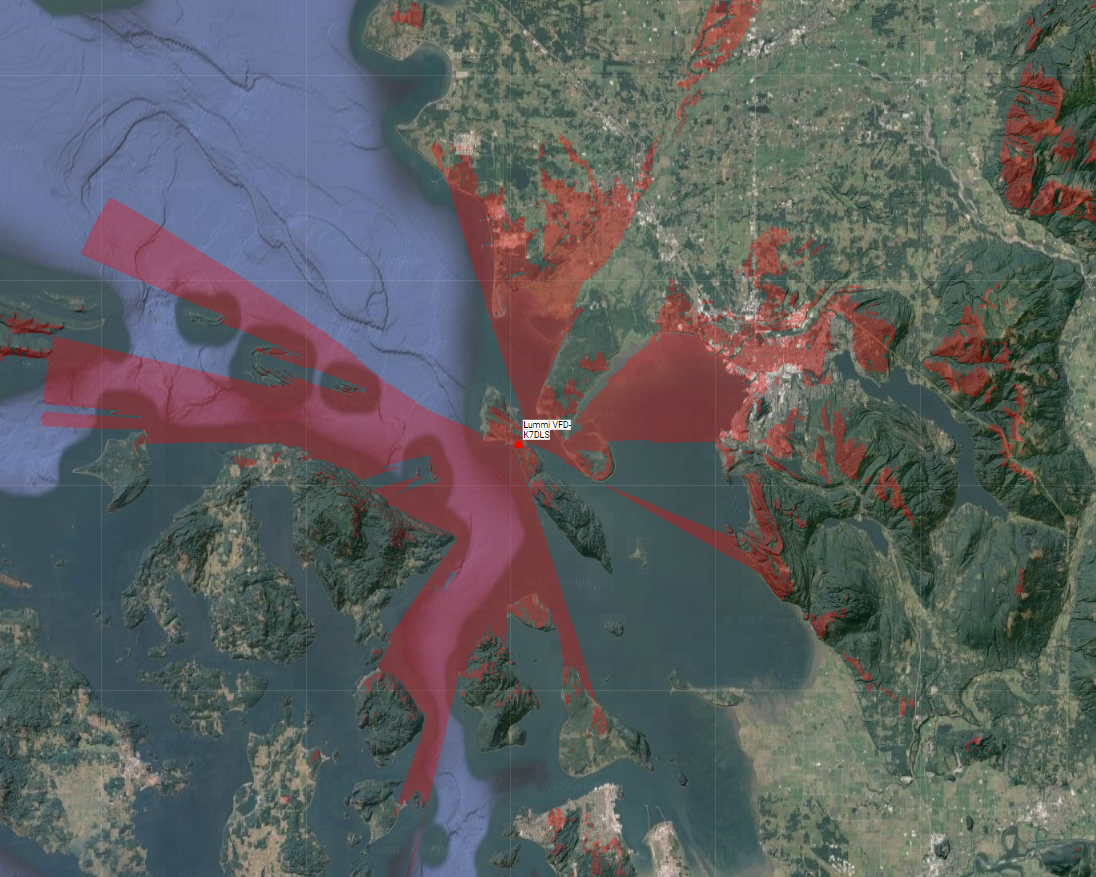

I may have a tower on or near the summit of Lummi Island soon. Shooting to co-locate with the VFD site. 80' Rohn 25G available. Looks like it would cover Victoria, Vancouver and Bellingham plus ? Dave K7DLS

If I have the location right, it's unfortunately in a bit of a hole. Lummi Mtn to the SE and other island peaks to the south and west limit the coverage. It does touch a fair amount of downtown Bellingham, but getting outside of that still poses a challenge. It does look like it would definitely provide connectivity within northern Lummi Island itself and over to Bellingham though! If I have the location wrong let me know - it may change the LOS map. Cheers, Rob - NR3O -----Original Message----- From: PSDR [mailto:psdr-bounces@hamwan.org] On Behalf Of Chris S. Munz-Michielin Sent: Saturday, March 25, 2017 7:50 AM To: psdr@hamwan.org Subject: Re: [HamWAN PSDR] Possibility What's the line of sight like to Victoria, Triangle Mountain (48 25'26.4"N 123 30' 59.9W). We have an existing cell site there and are looking to improve our connectivity to the rest of the network. Chris VE7ALB On 3/25/2017 12:06 AM, Dave Speed wrote:
