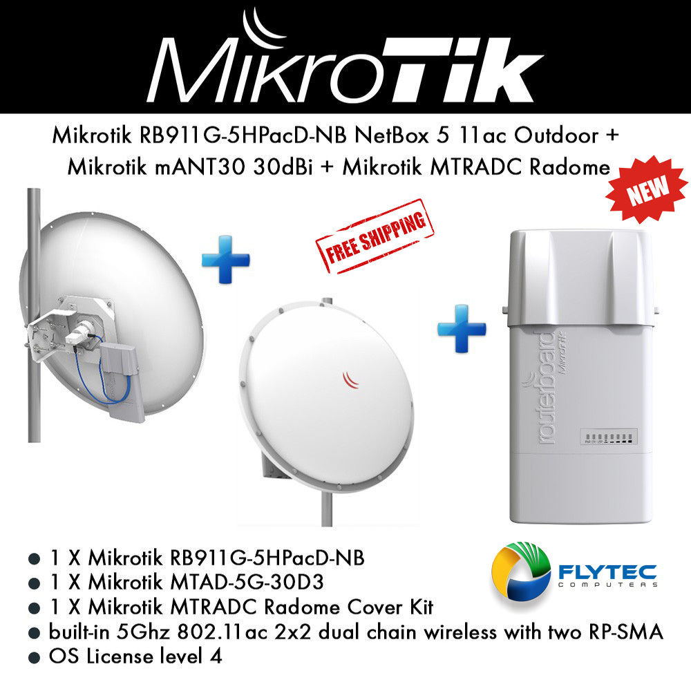

Thank you for saving me a lot of money! I will continue my quest for compatible hardware.

That wont work; that radio's wireless chip can't go to channel widths less than 20 MHz, and HamWAN uses 10 MHz channels. Generally, you're safe to use mikrotik gear that is not 802.11 AC, unless it has the QCA9892 chip (that's AC and it can do 5/10 MHz channels).

This Todd Lilleness,KG7VRV, Lake City. I am curious if this equipment is compatible with the PSDR HanWAN infrastructure;
[image: Inline image 1]
