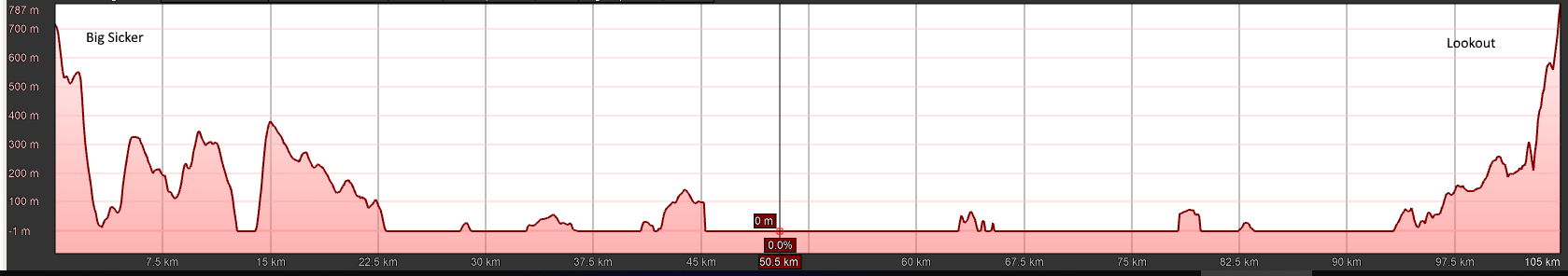

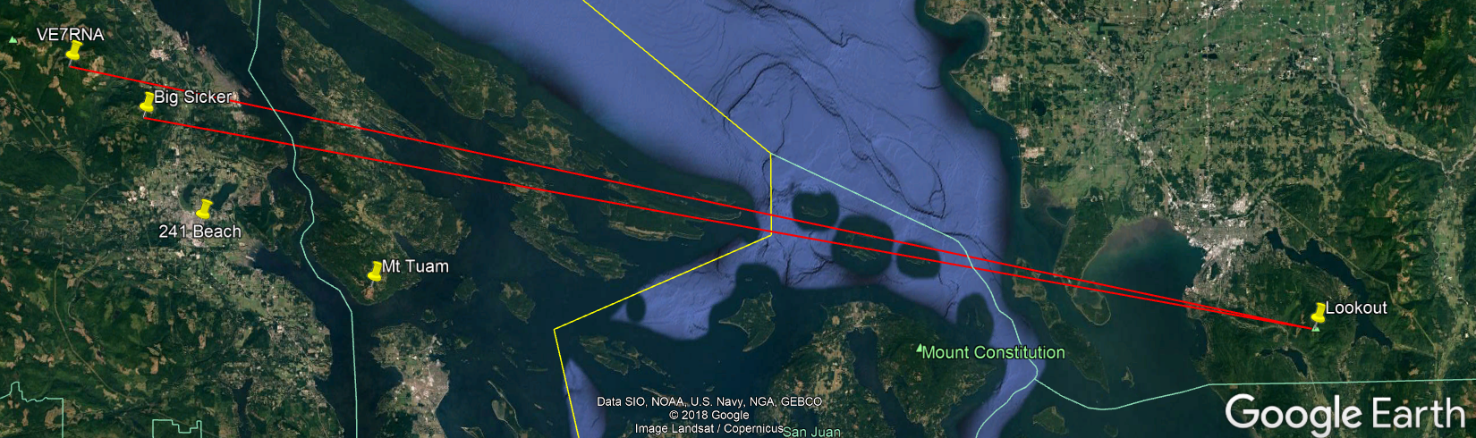

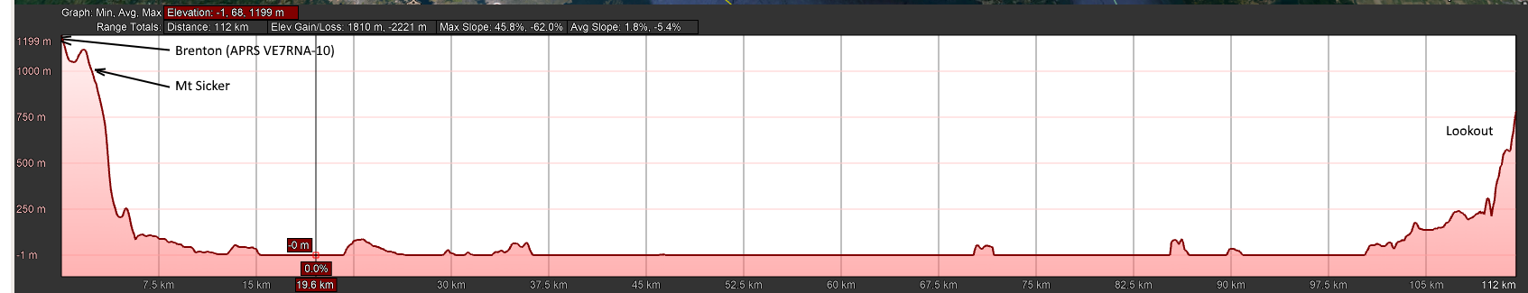

Scott, Darcy, CVARS is also interested in connecting from Mt Brenton or Mt Sicker on Vancouver Island. Now, I know that these are LONG drops, but I should still like to explore the possibilities. CVARS is connected to BCWARN through Nanaimo as well, but I am looking at making the link(s) to the mainland more fault tolerant. Steve Bradshaw VE7CBH From: PSDR [mailto:psdr-bounces@hamwan.org] On Behalf Of Darcy Buskermolen Sent: 16 November 2018 03:44 To: Puget Sound Data Ring <psdr@hamwan.org> Subject: Re: [HamWAN PSDR] Adding Metro Vancouver to HamWan Scott, PSDR is in the process of lighting up an additional site known as lookout, which, we've done coverage studies for in the past and shows coverage into the LML, You can find co'ords in the following URL: http://wiztronics.com/sites/lookout/lookout.htm -- Darcy Buskermolen - Network Operations - BC Interior - hamwan.ca <http://hamwan.ca> VA7DBI On Thu, Nov 15, 2018 at 10:13 PM Scott Leaf <scott.e.leaf@gmail.com <mailto:scott.e.leaf@gmail.com> > wrote: Hi this is VA7SL of the North Fraser ARC. We are interested in connecting to the Puget Sound ring. I have done a path study and it is excellent from here on Thornhill in Maple Ridge, BC to Mt Mcdonald. Is there any RF point towards Maple Ridge or could there be? 73 Scott VA7SL -- _______________________________________________ PSDR mailing list PSDR@hamwan.org <mailto:PSDR@hamwan.org> http://mail.hamwan.net/mailman/listinfo/psdr
