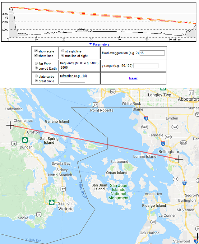

Ohh, didn't see that suggestion. Looks a pretty easy hop. Here you go.
I just go here and do a little creative summary. http://www.heywhatsthat.com/profiler.html

Would be interesting. Lots of open water over that curvature.
[image: image.png]

That would be a great node. It could be both our link to PSDR and an alternate to BCWARN. I am assuming that Constitution would be a powered site so the power budget would not be an issue as it is on Brenton. A link to Brenton <== ==> Constitution <== ==> VICROY (New Westminster) would be a viable solution and would provide an alternate path to BCWARN and a connection to PSDR. Thoughts? Steve VE7CBH From: PSDR [mailto:psdr-bounces@hamwan.org] On Behalf Of Mark Weisenfeld Sent: 27 July 2018 18:28 To: psdr@hamwan.org Subject: [HamWAN PSDR] Path to Lookout Ohh, didn't see that suggestion. Looks a pretty easy hop. Here you go. I just go here and do a little creative summary. http://www.heywhatsthat.com/profiler.html _____ From: PSDR <psdr-bounces@hamwan.org <mailto:psdr-bounces@hamwan.org> > on behalf of Kenny Richards <richark@gmail.com <mailto:richark@gmail.com> > Sent: Thursday, July 26, 2018 12:55:00 PM To: Puget Sound Data Ring Subject: Re: [HamWAN PSDR] PSDR Digest, Vol 65, Issue 12 We need a relay site on Mt. Constitution, would make these shots so much easier.... Kenny On Wed, Jul 25, 2018 at 4:24 PM Steven Bradshaw <ve7cbh@gmail.com <mailto:ve7cbh@gmail.com> > wrote: Mark, is that for Haystack? Can you do another for Lookout? Steve From: PSDR [mailto:psdr-bounces@hamwan.org <mailto:psdr-bounces@hamwan.org> ] On Behalf Of Mark Weisenfeld Sent: 25 July 2018 12:19 To: psdr@hamwan.org <mailto:psdr@hamwan.org> Subject: Re: [HamWAN PSDR] PSDR Digest, Vol 65, Issue 12 Would be interesting. Lots of open water over that curvature. ****************************************** Mark Weisenfeld K7TUM CN87na <http://www.levinecentral.com/ham/grid_square.php?Grid=CN87na> (SW corner) **************************
More links the better. Still a long shot at nearly 60km from constitution to Viceroy. On Sat, Jul 28, 2018 at 7:30 PM, Steven Bradshaw <ve7cbh@gmail.com> wrote:
That would be a great node. It could be both our link to PSDR and an alternate to BCWARN. I am assuming that Constitution would be a powered site so the power budget would not be an issue as it is on Brenton. A link to Brenton ç è Constitution ç è VICROY (New Westminster) would be a viable solution and would provide an alternate path to BCWARN and a connection to PSDR.
