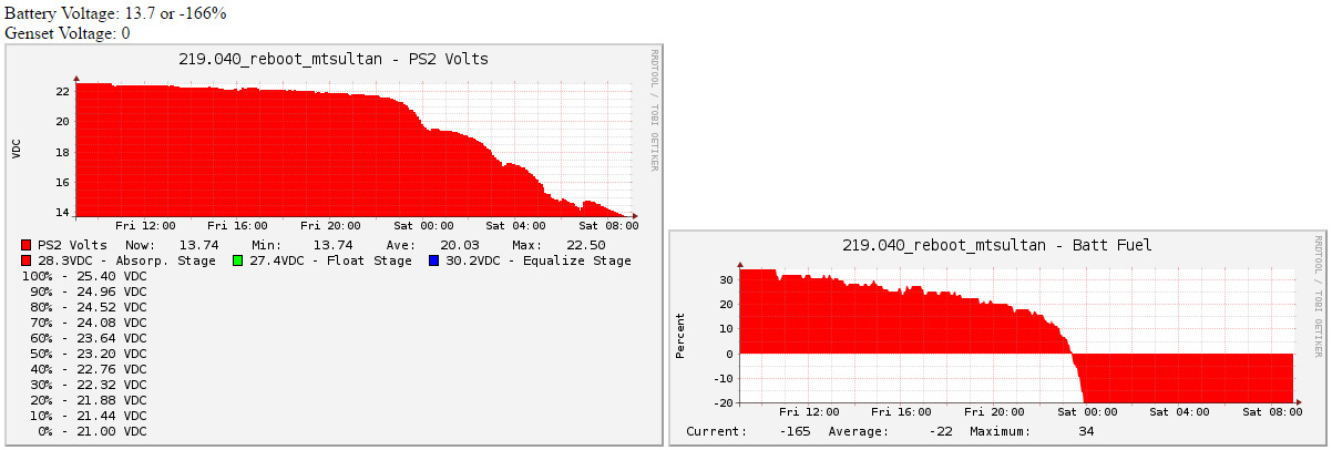

Something has gone seriously wrong @ Haystack. We're down to 14V on the 24V battery bank: Ryan's already 1/2 way up on foot, and I'm leaving now to follow him on snowmobile. Site will probably die in the next couple hours, before we even get there. Boourns. --Bart On 2/9/2017 4:31 PM, Nigel Vander Houwen wrote:

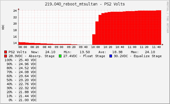

Ugh, Thunderbird SUCKS at handling pasted images: --Bart On 2/11/2017 11:58 AM, Bart Kus wrote:
Unfortunately they're much larger (260Ah/ea I believe) batteries that make up the bank there. Ryan fixed it just before 10:00AM today:
Looks like there was some power mis-wiring on the last emergency visit up there. That one was to fix a low oil condition in the generator that prevented it from supplying emergency charge to the batteries when needed, and to provide the DMR repeater with power toggle capability since its Ethernet locked up once. During the DMR power toggle wiring, a critical charger was mis-wired and was no longer able to charge the bank.

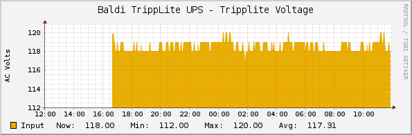

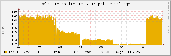

In other news, after DAYS of running on generator power @ Baldi, we finally got back onto utility power yesterday around 4:30PM:
Baldi TrippLite UPS - Tripplite Voltage
Here is the history of the whole event:
