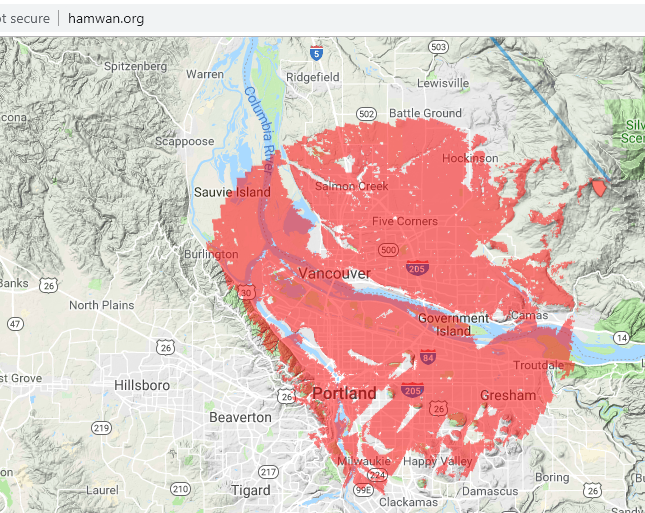

You could look at the map on http://hamwan.org to see what the mathematical models predict as coverage for any given tower. [image: image.png] <https://www.avast.com/sig-email?utm_medium=email&utm_source=link&utm_campaign=sig-email&utm_content=webmail> Virus-free. www.avast.com <https://www.avast.com/sig-email?utm_medium=email&utm_source=link&utm_campaign=sig-email&utm_content=webmail> <#DAB4FAD8-2DD7-40BB-A1B8-4E2AA1F9FDF2> On Sun, Dec 30, 2018 at 8:26 PM Edward Cukiernan <ecukierman@gmail.com> wrote:
